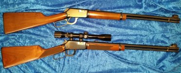

My XTR 22lr and 22 Mag

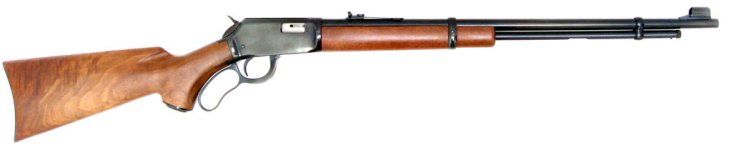

I had one of the 9422 XTR Classic Models that I bought new in 1986. I think I ran a couple of tubes of ammo through it to check the sights and then cleaned it and put it away.
When they started bring stupid money, I decided that I didn't need it anymore. Now that they are bringing about 2X what I let it go for, I wish that I hadn't sold it. In fact the only model that I think outdoes it in the coolness factor is a 9422 XTR Classic chambered in .22 WMR.
And while they are accurate enough to benefit from the addition of a scope, no way would I ever spoil the trim lines and balance of one by scoping it.
