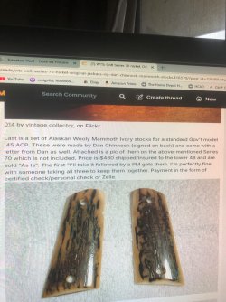

Grips that I have seen advertised by respected 1911 grip makers are not exactly cheap. It's reasonable to expect more material for revolver target grips,so higher price. Maybe less so for service grips?

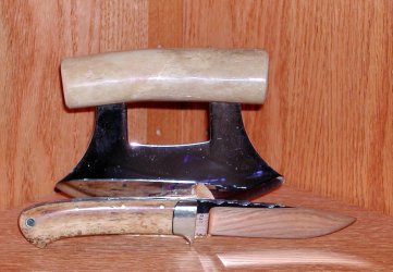

Depends on the tusk. Even buried in the permafrost for thousands of years many have held up remarkable well. The surface ivory, where the colors and character are found is often stabilized and some is epoxied to a backing (carbon fiber?) for strength. The interior ivory is often quite solid and stable with a creamy white look that can be hard to tell from elephant ivory if it's schreiger lines are not visible. As far as a test; the schreiger lines will tell the story as will the look (usually) but the various states either don't want to train enforcement people or they just want to take the easy road and ban it all so they don't even need to try to determine the type. In Illinois it is illegal to buy or sell (but you can own it) ivory no matter the source. Got to protect those 10,000 year old Mammoth remains you know.
This is Mammoth Ivory

Ralph, what're are you seeing the mammoth grips, and what do you consider reasonably priced?
