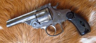

I wish I still had this one or at least gotten pics. It was a .38 S&W top break DA. The markings were this.
SMILL & WELSON. SPRANGFELD MUS. Followed by the normal patent dates. The dates were all one digit off from a real S&W.
Sorry to resurrect the thread. Here is a Smill and Welson :)
