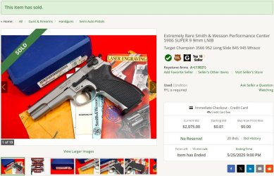

Sales 2017-2025
Product Code 148470 Domestic Version:
KJF4579
KJF4582
KJF4593
Product Code 108099 International Version:
MSF6982
MSF6994 (only one barrel, one mag, no box, minor surface rust)
MSF6994 again (only one barrel, one mag, no box, rust cleaned off)
MSF6894
MSF6991 (listed as new in box)
MSF6970 (sold by RockIslandAuction)
MSF6932 (listed as "Sold" on Guns International, the price was not shown in the text, but the picture included it. Also the sold date was not included, but I'm assuming 2020.)
MSF6990 (sold by RockIslandAuction)
MSF6970 again (sold on Guns International, the price was shown on this one when using a print preview. The sold date was not included, but I'm assuming 2020.)
MSF6914
MSF6994 third time (only one barrel, three mags, no box)
MSF6889
MSF6908
Product Code 148662 International Version:
TDM9476 (single 6" barrel with muzzle weight, imported from Germany - WISCHO)
MSF8808 (single 6" barrel with muzzle weight, imported from Germany - WISCHO)
TDM9504 (single 5" Performance Center barrel, imported from Germany - WISCHO)
