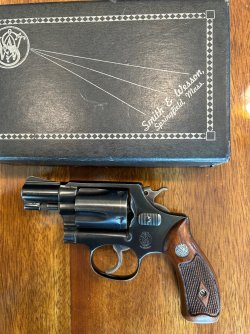

Finally got one. I was the only bidder, so I wasn't sure if it had been overlooked as a Baby Chief because of the ramp sight and the lack of reference to "baby". I would have preferred the half moon sight version but I haven't seen one come up for awhile.
It came in today and I'm thrilled. All original, all matching including the itty bitty grips, doesn't appear to be carried or shot too much, serial number 19xxx. I'm still on the hunt for the earlier version but this will do for now. Good collecting day so far (y)

That is a nice example. I'll take a stab at a ship date - perhaps late 1952? Bob will be along shortly to pin down a ship date for you based on a lot more knowledge than I have.
All said, it's a good looking Baby Chiefs, and a box too! Is it numbered to the gun?

No, the box is not numbered to the gun and the gun should have a 1952 date. . The gun came with a box but it was from around 1955 or 1956. - it had the old style cover with the 3 lines and proper label but had the printing inside. This box I had bought some time ago and is the earlier style with no printing inside. It was also unnumbered but comes from the pre-1955 era.
Very nice,
The steel stock medallions are a hint of its age IMO.
The style just prior were made of plastic for around 1 year and nickel plated brass before that,
Iirc the very earliest examples that I've seen had the older style service stocks and cylinder latch (pre flat latch), Also Iirc there is another variation made just after the half penny front sight but just prior to yours that has a smooth ramp without serrations.

Based on all the 19xxx serial numbers in the database I'd say there's a good chance yours shipped in the last quarter of 1952.
The serrated front sight began after serial number 12750.
Yours would have come in a red box.
