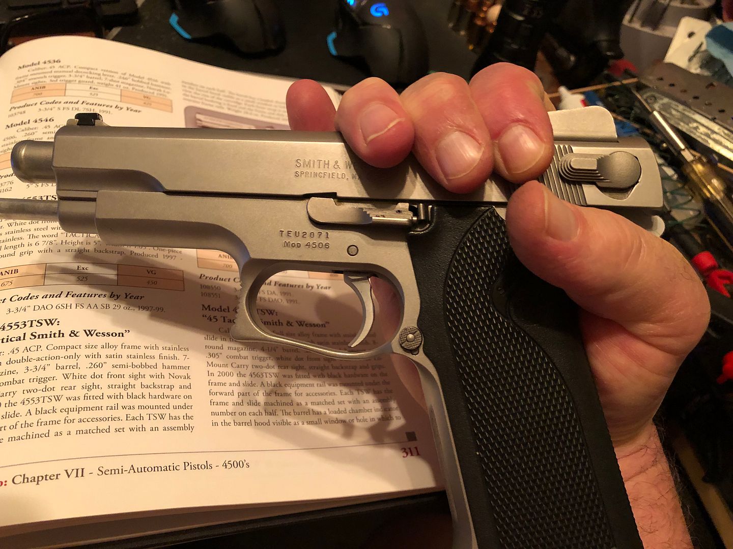

Originally Posted by creeksidewilly View Post
I tried holding the slide back a bit to ease pressure and it won't budge.
Better be holding the slide back more than a "bit"...

After the slide is pulled back to the position shown in BMCM's pic, mine have always been loose enough to press out of the right side with finger, then grab the left side and pull it out.

You MUST align the slide/frame, as illustrated in BMCM's post/pic, to create clearance for the raised portion of the slide stop lever when pressing it out the left side of the frame.
In this pic notice the raised steel ledge on the top surface of the lever body inside the yellow ring. This raised steel area of the slide stop's body can only clear the inside of the slide if the slide is properly positioned.
I've had any number of guys & gals bring me their 3rd gen's at a cleaning station at our range, telling me their slide stops are "stuck" and they can't field-strip their pistols.
Granted, occasionally you may find a slide stop body (curved notch in pin) and/or guide rod plunder (head) that may have developed a noticeably burred spot on one or the other, and it makes moving the slide stop pin across the compressed guide rod plunger a bit more difficult. Normal machining marks on the pin bodies, inside the curved cut, are ... normal. I sometimes add a very slight dab or oil or grease at that spot.
However, in my experience the significant number of instances where someone was having trouble field-stripping their 3rd gen gun wasn't due to burrs, but to an improperly positioned slide notch not allowing clearance for the slide stop's raised ledge to clear the slide rail.
Even when I demonstrated how to hold the slide/frame in the proper relationship (using the same 1-handed grip shown by BMCM), and then had the issued user try it, very often the person would start with the right grip on the slide/frame (which is under tension from the recoil spring, remember) ... but then forget to keep the exact slide/frame alignment while transferring his/her attention to the other side of the gun, pushing on the right end of the slide stop pin ... and the slide/frame alignment would shift just enough to again put the slide in the way of the raised ledge of the slide stop body.
In other words, they were trying to shove steel through steel, and the steel-against-steel contact was always going to defeat their efforts. It doesn't take much "slippage" of the slide's position to lose the proper notch alignment over the top of the slide stop, and I sometimes had to repeatedly demonstrate how they had to keep the slide/frame alignment in the proper relationship while shifting their attention over to the other side of the gun and pushing against the other end of the slide stop body's pin. It's easy to lose the attention needed for one part of the task when shifting focus on another part of the task, especially when a recoil spring is constantly trying to push the slide forward.
Now, if the slide stop's raised ledge (or a part of the slide's rail on either side of the takedown notch) has been damaged by someone having beaten on or otherwise tried to force the steel ledge through the steel slide rail? Well, that's another sort of problem.
While I've never personally encountered a damaged guide rod plunger spring that wouldn't permit the plunger to be depressed, that's also something I check, looking for normal movement of the plunger in the old style "pinned/staked" guide rods. In the newer revision of the guide rod assemblies the plunger spring and plunger can be removed and replaced (spring snaps onto the plunger bases).
Experiencing difficulty in field-stripping a 3rd gen isn't a matter of "using a hammer" to beat on the right end of the assembly pin, and especially not a bigger hammer , but aligning (and holding) the slide over the frame to create the necessary clearance so the slide stop can be moved out the left side of the frame & slide.
Sure, every once in a while, in a very old and very dirty gun, I might need to use the flat end of a handy plastic stick pen to push against the right end of the pin (hand pressure only) to get it moving.

There's a spring loaded plunger in the recoil spring guide that fits into a detent on the shaft of the slide stop. Sometimes, the plunger doesn't move as freely as it's supposed to. Not really sure why, but good old fashioned rust or gunk may be responsible.
What you might try is to get a cheap aluminum foil small container, pan or jar , fill it with kerosene and submerge the slide in it for a week or so. [You don't want the stocks in the stuff.] You'll want the fluid depth enough to cover the slide stop. If the cause is a stuck plunger, this should take care of the issue.
When we carried the 3rd generation guns, you could tell who wasn't doing a good job maintaining their's when it came time for the mandatory cleaning after training.

The pistol is on hold for a bit. This week has been prep & painting. (still) The pistol is temporarily buried somewhere in the bedroom and it will be a bit until I can get to it.
The plan is to soak it in kerosene as was suggested and if that fails, I'll send it to my gunsmith buddy.
Unfortunately painting is the present agenda. IIRC, it used to be faster and easier, but I ain't dead yet.

I soaked it in kerosene for a week with no results so I sent it to my gunsmith friend.
He just called and now I must declare my idiocy publicly to atone to this august body.
I wasn't pulling the slide back far enough to find the notch. I focused on the other end by the slidestop cut , so I'm embarrassed, but happy.
Thus ends my quandary.
Thank you all for the help. I guess it just wasn't connecting for me, but once he explained it the bells rang and the Celestial Choir sang.
Your willingness to help is greatly appreciated.
