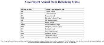

The stock stamp OG indicates that is an Ogden Arsenal re-build. Shoot away.

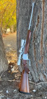

I’ll let you shoot mine - the only difference is it’s stainless and it’s been fired. Other than knowing it’s a limited run for Lipseys, I don’t know how many were made. Don’t care.
