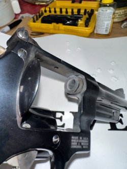

My local Ace does have gun screws, so nothing to lose in removing the existing screw to determine if it's merely a matter of cutting a replacement to the proper length.
Wish me luck!
Here’s the envelope of the replacement screws. Forster brand, can’t remember the vendor. I’ve only shot this gun maybe 50-75 rounds and probably half were .38 spl. It’s hard to see the burn marks with a cheap IPad camera, but they’re there. I keep forgetting about taking it to a smith.

Contacted S&W customer service, and received a, "Sure, we'll send you a couple of longer screws." OK, so that's an improvement from ignoring my request that they replace the screw while they had it.
The screw package indicates the screws are .010" longer, the screw was easily installed, there was no loctite.
Took the gun to the range yesterday, having dithered for a couple of months.

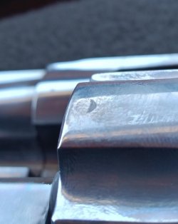

There are still distinct circular marks between the cylinder flutes, but it cleaned without abrasives or excessive scrubbing.

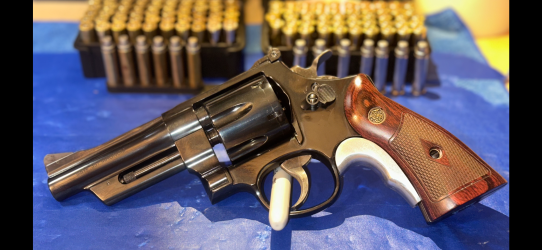

How did it shoot? Without any load development, using components on hand, I was able to put the last eight rounds of 50, into 3.75" at 50 yards. I think there must be a bullet/powder combo that will shoot into 3".leaf screw3.jpgcylinder.jpgcylinder2.jpg

I've seen some videos showing discoloration to the exterior of the cylinder, between the flutes, apparently caused by gases "swirling around" the hole in the top strap for the screw that retains the rear sight.
Older Smiths have the screw farther forward, and the hole is not drilled completely through the top strap, so it's not an issue.

There is no damage. Just a cleaning issue which is no problem for stainless revolvers, but blue revolvers need something like the ProShot metal polishing cloth to remove the marks.

If you would like damage be sure to use a metal polish.
The ProShot metal polishing cloth is soaked in some sort of clear liquid that wipes the cylinder marks right off without damage to the bluing. The package says safe for factory blued finishes. It was recommended to me by someone on the forum.
If the blued surface has to be scrubbed to the extent that the bluing is removed along with the firing residue, I would consider that damage.
And that is the reason I use the ProShot metal polishing cloth. It does not remove any of the bluing. It is not a polishing compound or anything. Just a soft cloth pre-soaked in their clear liquid. A couple wipes and the crud is gone. And the bluing is just fine. It says right on the label that it is safe for factory blued finishes.
