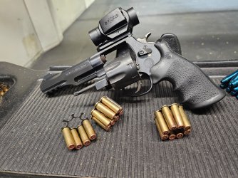

Anyone every tried them? 8 shot ? Kinda like dropping hot spaghetti in the 8 charge holes at once.
Observations.?( yes. 38 short colts do have them beat . But kinda digging the accuracy and 38 cal hole puncher ) big clean holes.
Since speed wasn't a factor, shooting bullseye. All I did was sit the wadcutter moonclip on the cylinder and wiggle with my wrist on the grip. They all inserted like that. But willing to hear any hints that anyone has tried.
I know , I know. Moonclips with wadcutters feel like "square peg round hole" type of a moment.
But was getting amazing hits!!

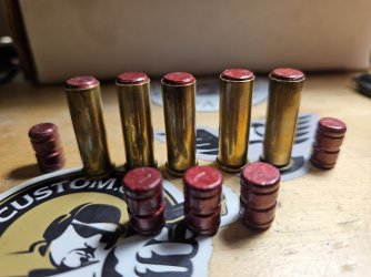

The ones I'm making now, from my past " 38 wadcutter " thread are around 1.180" ( I think)
They have a tiny head peaking out, and somewhat helps.
