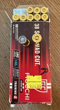

A couple of years ago, I bought four boxes of Fiocchi .38 Wadcutters. Although the ammo is pricey, I have found the brass to be excellent for reloading the same type bullet. These are reloaded with Winchester primers, Hornady 148 Grain HBWC over 3.0 grains of Winchester 231.
