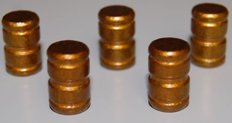

Hello everyone!
I was just making some 38 special 148gr wadcutters yesterday and noticed I was wrinkling a few cases. At first, I wrinkled 3 cases out of 50. But then I made 50 more and wrinkled a few more cases than I wanted . Maybe 8 or so.
I tried readjusting my dies. Making sure at first, I wasn't adding too much of a crimp. That didn't seem to work. Then tried to not add as much height??
Book states they should be at 1.160". I left some at 1.180". In my experience, not too far off. Using 3.2g of w231 on a powder coated 148gr.

I didn't notice I had this problem when using Barry's 148gr DEWC. This is something that just started happening when I switched to the 148gr powder coated ones. .358" dia. Also.
Should I just get used to sizing them after?! Or am I missing something??

The tall 1.180" ones do have maybe about 1/16 th of an inch poking there heads out. Also, I'm using 38 special lee carbide dies. I don't know if that makes a difference. Wouldn't I have to run plated ones at 3.5g with w231/ hp38 ? I've wanted to run the 3.2g with the lead PC. They seem to pop about the same. No chrono taken at this time.

The wrinkles were halfway and below the bullet. And won't chamber.

Well, I ( we) figured it out. Opening up the cases more helped in the insertion and crimping the bullet. Although it helped, it was still wrinkling the cases. It did it also on some Aguila that I have.
Working backwards forwards, I decided to turn in the bullet seater, making a harder crimp. That was it.
The way I'm thinking that it works was that the die itself was not deep enough to crimp the sides and the tip of the bullet. I found that out through Alk8944's suggestion the bell the case mouths more. Well, I did a few of those and noticed the bullets were still too wide at the tip. Meaning, the die was just compressing the bullet and not enough surrounding the bullet to resize it again.
So that was it. Thanks to all who took the time.
