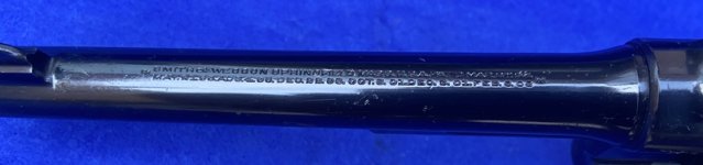

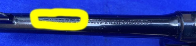

1406 - NO S&W or CAL ROLLMARK
Excuse my ignorance but what is meant by the above ?
It’s not marked SMITH & WESSON or the .455 caliber on the barrel.
That's what I thought it meant
So it appears that when I post pics you may not be seeing them on your thread as it clearly states both Smith and Wesson and the calibre on the barrel ??
SEE PICS BELOW
or am I missing something here ???

Dave,
Look at the barrel photo in post number 454 above. That’s the roll mark I’m documenting among other facts from all guns reported in this thread.
The .455 on the gun you posted is the British proof mark, not a factory marking. I hope that helps and thx for asking.

OK now I understand
Is it likely that post #454 is of a commercial firearm with "commercial" markings - whereas my pics are of a S&W supplied to British Government
Post #1 explains the system being used to determine which “type” the revolver fits.
Type being a collector’s classification and not a factory designation.
Kevin
OK now I understand
You're correct. However, the barrel roll mark is stamped (or not stamped) long before the gun is sold and therefore not relative to how or to who the revolver was sold.
I started the thread to identify the factory patterns for roll marking the barrel based on serial numbers. Of course many members who posted their revolvers like you supplied photos and other details like shipping dates, shipping destination, etc., as well, that I was also able to document.
