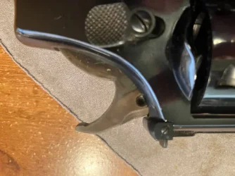

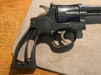

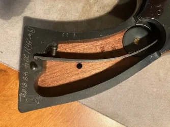

10 years ago, I posted about this 1905 4th target model with a humpback hammer; (never let it be said that I rush into things :)), but in July 2025, I finally broke down and requested a letter, which reveals that this gun left the Stockbridge plant on October 16, 1940 with a 6" barrel, a Humpback Hammer, AND a grip Adapter, headed for Folsom Arms in NYC. In my initial post, I identified it as going back for major work in 9/75, which was a typo; it should have said 9/65. Judging by the refinish stamps, it was probably for a new barrel, since it now sports a 5" with a non-barreled extractor rod to go with the beautiful bluing and an unserialed barrel. Unfortunately, the service records fail to show what work was done, as happens sometimes. Now I just need to find correct grips AND a K grip adapter (I know, fat chance on THAT happening)......:(

The 5" barrel is interesting with no serial, is it cut for a barrel extractor? guessing the barrel began life with a half penny M&P front site and was milled to accept the taller pinned target blade?

I, too, surmise that they simply took a 5" barrel with rounded front sight blade, milled and pinned the Patridge, and installed it. The barrel has no patent markings on top, nor is it relieved for the barrel knob extractor, which means they simply used a standard right hand thread rod from stock. I've enclosed the sheets which came with the letter, showing that the Humpback hammer and the grip adapter were purchased at the same time. It's a shame that the records were incomplete, as this was definitely ordered a target gun, based on the accessories. :(
