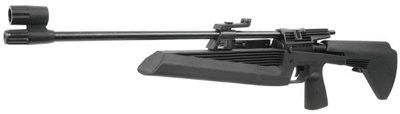

This is the one I have. There is now a version with better sights. Side cock lever like a FWB603. I use some pellets which are teflon coated with a silicon base which are about 75-100 fps faster than a traditional pellet.
