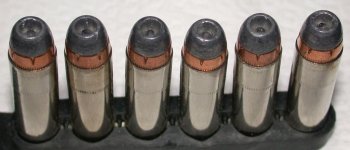

My SW MP340 likes the 38 special 158 gr +P
Practice with light 110 or 148 weight bullets.
I did not like how the 125 gr bullets tested out over the years
and did not like the recoil and time to get back on target with the 158 grs.
My best "All around" load for all my wants and needs came down to the
135 Gold Dot in my M49.
