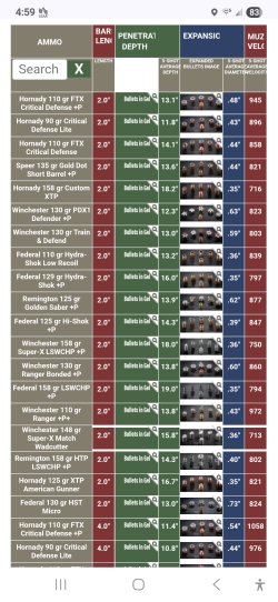

Speer 53720, 125 gr GD +P. Gave 12.58 inch penetration through 4 layers of denim, 0.54 in expansion from a 60.

And Lucky Gunner Labs, and then Paul Harrell's tests indcated to me it would be a reasonably good defensive round even with a short barrel revolver.

My employer issued the Federal 129 grain Hydra-shok .38+P for years, so that's what I carried. The 129 Hydra-shok did poorly in the Lucky Gunner tests. Since then, I've used several types, to include the Federal 130 HST micro, which did very well in the LG tests. But I haven't seen any of the 130 HST for sale lately.

I always find the Lucky Gunner tests to be informative. For .38 Spl. I refer to the following, scrubbing penetration vs. expansion vs. velocity. You might find it helpful as well...
