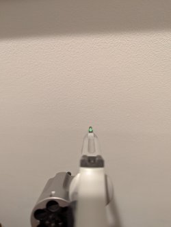

I was really excited when this revolver was released, and I finally bought one. Oof, not good, gents:
1. The barrel is not in alignment with the frame -- see pic. Viewed from the rear, it's canted a few degrees counterclockwise.
2. Probably because of #1, point of impact is way to the right of point of aim.
3. The trigger doesn't feel right. Instead of the long, even double-action trigger I'm used to on S&W revolvers, this one is mushy to a hard wall, and then breaks crisply. I suppose this could be subjective, but not what I expected/wanted.
This gun is definitely going back to S&W, hopefully they make it right. Totally unacceptable QC failure for a revolver at this price point.1000034527.jpg

One of the advantages of the two-piece barrel design used on these was supposed to be an end to improperly clocked barrels. The tab on the frame is supposed to fit into the slot on the barrel shroud for perfect alignment. I wonder how they already figured out how to mess that up.
I'm not much of a revolver guy and had no idea this was something I even had to worry about.
