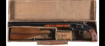

Another curiosity (for me) will be what looks to be a pistol/rifle (revolving rifle?) setup you can see 5th from left on the "collection pic".

Comments on the rifle (blow up the pics several times to see the 5th one from left).

That 5th from the left long gun sure looks like a S&W revolving rifle. depending on condition, it's around $8K+ and the Schofields are copies from Italy, but great shooters. Ed
good eye on RR
I don't know off any repros
That 3rd from the left long gun sure looks like a S&W revolving rifle. depending on condition, it's around $5K ++ The Schofields are repos from Italy, but great shooters. Ed
I kept counting to 3, but no RR. I think Ed has missed the last few years of auction prices realized for that rare model. It is the 5th from the left in my picture and they have been selling for near $10,000 without the leather case. Ask your friend if there is a case for that gun? If so, around $15,000 would be a probable sale price! Hard to tell for sure, but kind of looks like a 16" barrel. 239 were made in 16", 514 were made in 18", and 224 were made in 20". The last 320 RR I saw sold was an August Rock Island auction and the sale price was over $17.600.

As far as the revolving rifle? If you look closely at my zoomed in photo you should notice what appears to be a 44 cal cylinder and bore. Look at the 30 cal rifles next to it? The revolving rifle is 320. Which is actually close to 30 cal. The photo is not good enough to confirm anything but to me is alarming. If it has been caliber changed the value is much less.

I'm not familiar (from the photo) with the two rifles next to the Revolving Rifle. I believe the RR to be legit though.

Regarding the revolving rifle, again...he had no idea of what it was. I told him that if it does turn out to be a S&W Model 320 that is in original caliber and condition it could be worth some very serious bucks.
