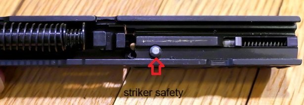

The BG 2.0 striker safety is not under the rear sight and the manual suggest moving the rear sight on page 35.
Also, if you ever need to clean or service the striker you will need to remove the rear sight (NOT suggested by me or the factory).
But it seems to me if you oil the striker safety the striker will get dirty.
I use Teflon powder on all my strikers.

As regards removing rear sights, yes, the BG1.0 has a safety plunger, captured by a plate held by the rear sight. Perhaps that's why you're not to fool with that sight.
Concur with OldBBB; no oil on the striker, and I blow mine out with compressed air, and check for free motion.
