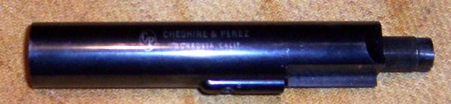

Like this one? Purchased the gun many years ago with the barrel already split at the forcing cone. Do not remember the "story" if there was one about what happened. Replaced the barrel and sold the gun off to fund another purchase.
