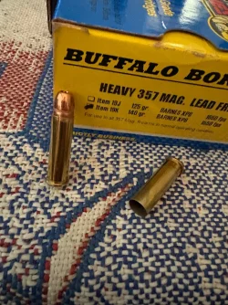

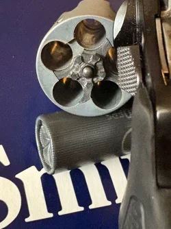

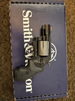

Hi everyone, I thought I'd go to the range yesterday and try out my 360 PD, and give it a good test. So I packed up my stuff and headed out. Going to try out 38 special, and 357 mag. Started out with 38 special, fired 15 rounds beautiful, great so I loaded the cylinder with 357 140 grain Buffalo Bore heavy load, so here goes boom and said to myself I'm not doing that again. Okay went to open the cylinder and can't guns completely locked up.so l got the range manager and asked for help not knowing what's going on, thought maybe a round jumped its crimping and jammed. So he says he'll get someone else guy, comes over and says he'll get someone else's now going on my third person and I'm waiting with a hot pistol still jammed. Third person says he has to take to the back, me waiting what happened. Nice guy comes back and got it open, shows me the case looks good then shows me the adjacent round bullet jumped the case by pretty much. Also shows me the brass split about 3/8 to 1/2" . And also shows me that the cylinder has cracked and there's a star arm missing on the extractor. 1 more thing theirs a scratch on the cylinder side probably getting it open. I did call S&W to start a warranty claim I have to send it to them. Never heard anything like this, any thoughts. Some Pic's, RayIMG_3447.webpIMG_3438.webpIMG_3436.webpIMG_3434.webp

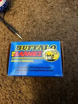

Buffalo Bore makes very hot ammo and does not adhere to SAAMI pressure limits. They have a unique approach compared to industry standard companies. They put warnings on their ammo saying not to use it on certain guns. Just because they label that box of ammunition as 357 Magnum, doesn't mean you can shoot it in any 357 Magnum firearm. Buffalo Bore says to use it only in steel frame guns and warns against using this load in any lightweight alloy framed revolvers.
Interestingly the box end flap is labelled as "For use in all 357 Mag firearms in normal operating condition." Except it isn't according to their website!
Here is Buffalo Bore's warning on their website regarding your particular load.
"Buffalo Bore type HEAVY 357 Mag. load and as such, should only be used in revolvers made of all steel. It should not be fired in a lightweight, alloy framed or cylindered revolver. Feel free to use it in ANY/ALL 357 mag. chambered rifles and all steel revolvers/handguns."
Make sure you disclose what ammo you shot to S&W when you return the gun. S&W will probably blame the ammunition (rightly so) and Buffalo Bore will probably say you should have read their fine print.
When I'm not shooting my own reloads, I chose factory ammo from the well established companies that adhere to SAAMI. Buffalo Bore touts some impressive ballistics but it comes at the cost of higher than standard pressures and increased wear on your gun. Plus their small print says not to use it in certain guns. Bear that in mind when you buy ammo.
Good Lord, you broke it on the 16th round!?! Contacting S&W is the correct 1st step... they'll fix or replace it. I'd also contact BuffaloBore customer service about that round jumping it's case. I've never had a problem with any ammo in my AirLite M&P 340, including .357 (besides the ouch factor).

When I purchased it I asked for 357 for my pistola, I know buffalo bore quality just thought its okay as 140 grain not less than 120 chalk up to experience. Thanks I'll heed your suggestions much needed.
Ouch! BB 140 grain in a Scandium framed revolver is purely masochistic! When I had one, I put a few fairly mild factory .357 loads through it, and that was pure hell. I ended up loading some practice .357 rounds that were a little hotter than .38 +P, but still short of the standard factory loads. I still hated shooting it and finally got rid of it.
Did the extractor star break when they were trying to eject the bad round? Hindsight is always 20/20 but I tend to keep my Buffalo Bore ammo restricted to the big, steel N frames. I have kept the 357 ammo that I use in my 360 limited to 158 grain, SWC rounds. I have had no issues with normal factory loads and use an older Winchester 158g lead SWC as my carry load. My guess is that your gun will come back to you good as new.

I understand that S&W tested the scandium alloy and titanium cylinder revolver extensively when they developed them and the revolvers will stand up to more shooting with SAAMI ammo (and proof rounds) than your hand will.
Not sure I was not there when he got it open I'm sure he used a mallet, I do know the spent case was stuck and he went back again. He came back again with the rounds out.
I'm going to bet that he wacked the extractor rod to get that stuck case out. I'm also going to bet that extractor rod is now bent. That's about the only way that an extractor star would experience the force necessary to break one of those arms. As counter intuitive as it may seem, the way to get a stuck case out like that is to gently tap it out with a range rod from the front of the cylinder. It all can be fixed.

Some great responses in this thread. These days I am one of S&W's harshes critics — but I cannot blame them for this one.
I would like to hope that S&W covers this but when you tell them what ammo you were using, they may protest.

The "No less than 120 gr bullet" warning is specific to the titanium cylinder guns. Even with SAAMI pressure ammo, the powder gasses from 110 grain JHP ammo will erode the finish on the face of the titanium cylinder. Thus S&W warns against it. It isn't a problem with 125 gr or heavier bullets. There is something specific to the pressure time curve of the super lightweight bullet loads that is very erosive to the cylinder. This isn't a concern with steel cylinders, just titanium. It also is an entirely different problem than Buffalo Bore however. Theirs is just plain loaded way hotter than normal factory ammo regardless of bullet weight.
I do want to say that Buffalo Bore ammo fills a very specific niche in providing extra powerful ammo for certain applications where a very knowledgeable consumer can know what guns to shoot it in and which not to. In my opinion, their ammo shouldn't be on the shelf alongside normal ammo for an unknowing customer to buy.
Imagine you pulled up to a gas station and noticed alongside the normal 87 octane pump, another pump which sold Elephant Engine "gas" which delivers an incredible increase in horsepower and miles per gallon compared to regular gas. And you buy a tank full... and it breaks your crankshaft and destroys your engine as you pull back onto the highway. Your first instinct is to blame Ford or Chevy or GM or whomever made your car- and then you get on the Elephant Engine company's website and it warns in the fine print that it's not for use in a family sedan and should only be used in heavy duty trucks. That's kind of what happened to you and your gun.
