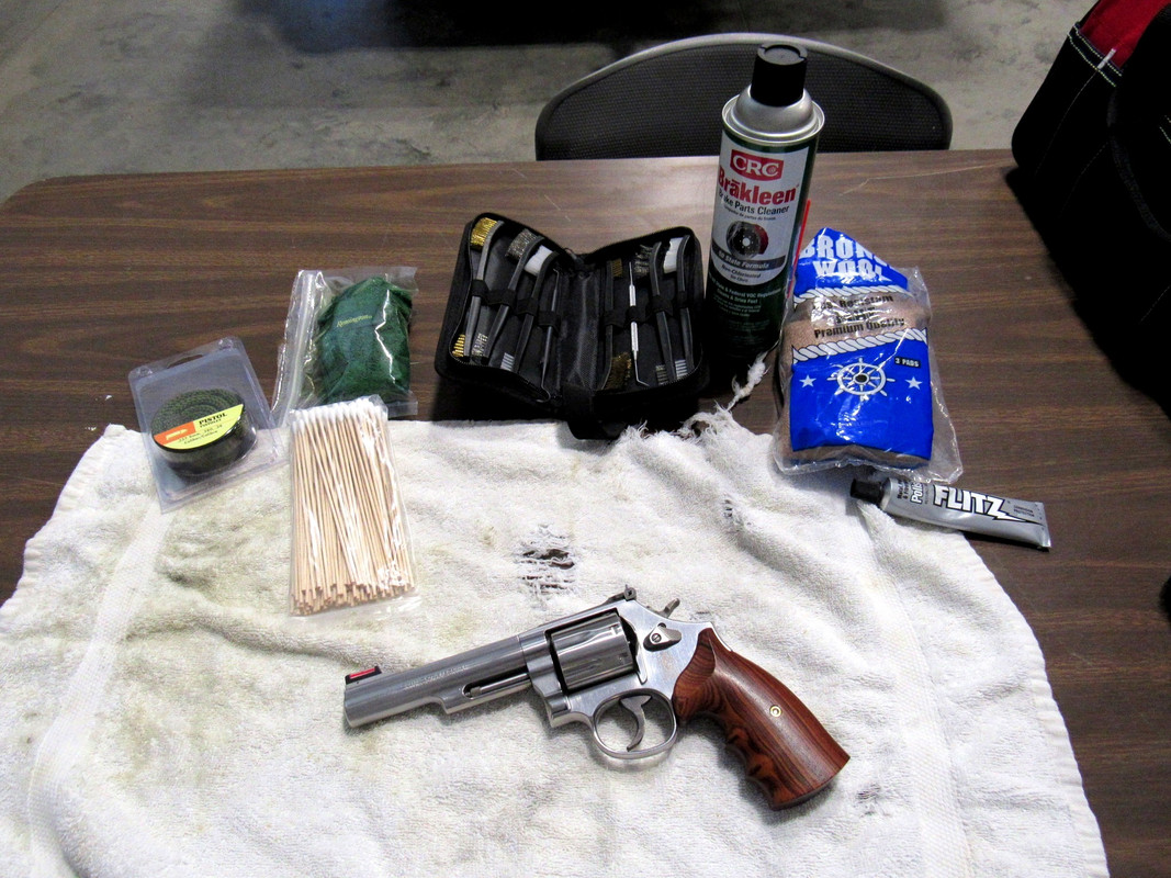

One week prior to this thread I used Flitz on a beater 1917 commercial. 99% of the bluing came off. I was not aggressive. I will put up pics on another thread. I’m hoping I took off a bad old reblue and not the original finish! Be careful gents.
There are 2 products: Flitz wax in a black squeeze bottle and abrasive Flitz in the tube as pictured by the OP. I used the tube product. Dave

I lightly applied the Flitz with my finger and lightly rubbed mainly because I had never used it before and wasn't sure just how abrasive it was going to be.
The two guns that I have polished with Flitz there was no sign of any bluing left on the polishing cloth.
Right now I wouldn't hesitate to use it on any of the other blue guns I have.
Very nice, one caveat Flitz can remove bluing if you are too aggressive.It is also excellant for nickel and stainless.Mothers Mag wheel polish works well and is not quite as aggressive on blue guns.A coat of paste wax such as Renaissance Wax is a good follow up.BTW nice model 27.
If "too aggressive" means applying with a buffing wheel or with a pressed cotton wheel Dremel, you are correct but it will not be the Flitz removing the blue but the wheel, itself.
HOWEVER, when applied with a soft cloth by hand, Flitz will NEVER remove an original blue finish.
It WILL, remove paste blue and touch ups in a heartbeat.
If you start wiping down a blued gun with Flitz to see the rag start turning black ... that's paste blue it is removing. When you're done removing the paste blued areas, what you have remaining will be the original finish. No, 3rd way about it.
Very often guns you think are clean ... don't be surprised or scared if with a light wipe of Flitz the rag comes up light brown ... it is removing the microscopic rust / oxidation. That is perfectly OK and a very good feature about Flitz.
I'm another who has never seen any evidence that Flitz will damage a blue finish. I'm sure it will if you really set your mind to it, but I work lightly, slowly, and by hand. I'm trying to polish something, not sand down a tabletop.
