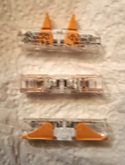

Well, dogs chewed through the cord on my lawn mower that went from the motor to the switch on the handle. I thought, "Better break out the wire nuts", but I didn't like the idea of using them in place where they could get pulled on. I found something better. Wago lever locks. Skin the wires, stick them in the ends and close the levers. Then tape up the whole works. They worked like a champ and did a neat job. They come in a variety of configurations, gangs, etc. and can take from like 22 to 12 ga wire. See pic. The top one has the little levers open.

I like them because they are neater than wire nuts when the splice hangs out in the open. Also I didn't lose length that I didn't have because the wire that goes from the motor to the handle is only so long and I was missing a chunk in the middle. I don't think that they are faster than wire nuts, you still have to bare the wires correctly. The nuts twist on and the lever locks slip on. It wasn't a matter of speed.
