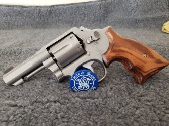

Everyone does what they want with their gun. Several people tried to say, don't cut the 586 no dash revolver:
Now I have the revolver I wanted.
Thank you.

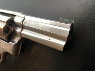

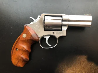

My friend just texted me two quick pictures of his converted 617, I believe it is a no dash and has a grip frame thats been round butted, the barrel began life as a Model 66 in .357 and has had the caliber rollstamp removed from the right side and a barrel insert in 22lr.
The gunsmith was Jim Stroh Of Alpha precision in Georgia

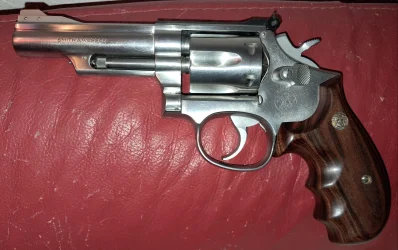

I picked up a 629 in Tucson that had the profile changed, as I bought it this way I don't know who did the work. Really nice job though, beautifully done. Being as it was Tucson, two high profile smiths in Phoenix, Nelson Ford and Frank Glenn maybe? I just had Nelson Ford fit a cylinder for me, really nice guy and he did a great job.
