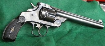

have a few question regarding an early smith & wesson 44 double action first model re
from the evidence presented and my own examples it appears the some were blue and others were white.
Not a definitive "tell" of a refinish
Wow iby,
I guess I struck a nerve.
Here is one of the best “Original Factory Nickel Finish” NM3 I have ever seen.
Take a deep breath, relax, and look closely at the photos of the finish. Notice the wear patterns, notice the location of finish loss, notice the “Blued” ejector.
This is an excellent example of surviving original factory finish.
Very rare to find one like this.
However, it’s very common to find a quality restoration.
It is also “Very Common” to find replaced ejectors because like I mentioned???? They are very often damaged!!! That’s a fact!!
Or is this my imagination??

Since the OP's revolver is a DA, I checked out a few.
mrcvs questioned: "Maybe some were blued and some “in the white”, depending on when manufactured?" I believe this to be correct and I believe the type of revolver made a difference also. My small sample:
Nickel had blue extractors (2). My 61xx nickel has an extractor that's in-the-white.
Wesson Favorite: nickel with blue extractor.
Wesson Favorite: blue with in-the-white extractor.
.38 Winchester: nickel with blue extractor. And,
.44-40 Frontier: nickel with in-the-white extractor.
There seems to be a pattern of nickel with blue and blue with in-the-white until the late production Frontier. The 61xx (N/W) is a special-order revolver which may explain the out of normal extractor.
I looked at a few NM #3 SA revolvers and they followed the N/B and B/W pattern except for a .32-44 Target that is N/W.
I have difficulty believing the OP's revolver is a replate.
From the photographs provided , it appears the OPs revolver has been renickeled. However, nickel finish is notoriously difficult to photograph.
The trigger guard and thumb latch are blued with condition, the case colouring on the trigger is good, the stocks have condition that match the rest of the revolver, +/- the nickeled/not blued extractor star.
So, draw your own conclusions and there may be no conclusive answer without handling this revolver in person.

I forgot to mention, any discussion relative to the black spacers between the mother of pearl stocks and the frame, other than not factory?
The mother of pearl stocks were most likely affixed by the distributor.
Yes the stocks are not factory. Dave's father put them on. He still has the original grips. I have never seen them but would like to see if they have a serial number on the back side. I appreciate the insight on the cylinder star.
I broke the news to Dave last night that the gun his father ought and loved as a first model is a Frontier model. I wonder if they would redo the factory letter since it was done for the incorrect model.

What I find interesting at this point is as pointed out by forum members the 1 9/16 cylinder points to the 44-40 yet if I understand the 44-40 guns had the caliber marked on the side of the barrel and this one does not. Of course perhaps it was polished off when refinished?
I have my Frontier and it's never been refinished as near as I can tell. It too doesn't have the caliber marked on the barrel nor does it have the S&W logo etched on the frame. Maybe someone knows when S&W started marking the pistols. Please note my earlier post wherein I mention that cylinder length can't be used as a definitive indication of caliber.

I also believe the factory blued the ejectors.
The one part that is often damaged is the ratchet teeth. To repair this condition is simple. Replace the ejector. A replacement ejector would be in the white. Early Major distributor catalogs clearly show every part available. They swap easily.
This gun was restored professionally. More photos would prove it. Part of a quality restoration would be to install a new undamaged ratchet/ejector to sharpen the action. No brainer.

Yes, the blued variation had ratchets that were nickel plated during the black powder ERA. I thought the focus was Nickeled guns? Like the Op's? Nickel plated guns had Blued extractors and ratchets.
Ratchets were often replaced as a tune-up measure during that time frame. They were readily available at "ALL Major Distributors"... I honestly don't understand why collectors don't except the concept. It's a no brainer.
The most common issue with collectors is having to swallow that a part on their antique is "NOT" factory original. They often throw a childlike fit even with the suggestion.
Antiques are not as durable as modern guns. I often shoot a model 3 TBDA 38. I've broken the bolt spring 3 times after about 700 rounds and the ratchet teeth are near the point of needing to replace the ratchet. I have replacement parts, and I enjoy shooting the gun so I'll just keep fixing it. Most antiques don't see 50 rounds shot through them by collectors. Most are safe queens.
The caliber stamp on the side of the barrel began in about 1902.
The S&W logo stamp on the right-side frame began about 1896/7 timeframe.
So if your Antique gun lacks the stamps then it originally left the factory before 1897.
