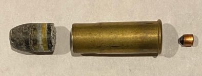

1. The attached photos is of a large pocket Western headstamped case.
2. Looking down into the case, one can see the large button and deep sides. This view in the photo is not seen correctly without the depth perception. However, the cut out shows details.
3. Of the unheadstamped cases I do have, they also have the large button on the inside, indicating they are not of the folded type. See last photo

Transition is proven.
Well Bryan,
I believe the original factory ledger since they were there when it happened. I believe based on that factory document along with the Winchester transition to "solid head" balloon pocket case in 1880. If there was no transition, why would they even mention it in the ledger? Why would they change the boxes to state: "Solid head case"? Something happened in 1880 and 1883 to Winchester and UMC cartridges.
I'd sure like to see one of those battlefield empty case pick-ups from the Little Big Horn in 44 WCF. Actually, I'd like to see them "ALL" to determine if they are legit to the battle. All you'd have to do is find one that is folded head. Since they've been shot you can look inside the case for the primer piece insert seen in photo 1. That would be proof positive.

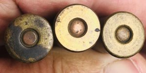

Photo 1 is the transition from folded head centerfire to solid head centerfire. Notice the insert without a case crimp to hold it in place found on the Bennet primed cases?
Photo 2-3 are examples of non-head stamped pre-1884 44WCF cartridges. Notice the one on the left? Has a crushed primer? Strongly suggests it was once reloaded a very long time ago. The other two look original to me but no way to prove it and I'm not cutting them open in search of a folded head insert. They are very hard to find.
Murph

Well Bryan,
Murph
