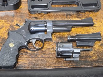

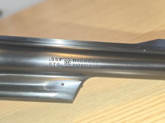

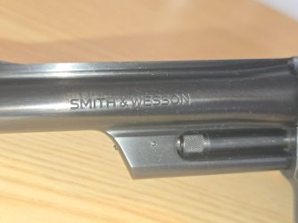

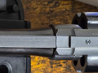

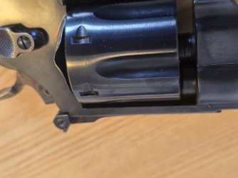

It was actually easier than I expected to change the barrel. I 'fabricated' an action wrench out of a long piece of angle-iron. I cut up an old bed frame into a 30-inch piece and an 8-inch piece, and drilled holes in both so they could be bolted together with the angles facing away from each other.
I then proceeded to remove the cylinder, and punch out the pin holding the barrel in place.
I ordered some curved vise jaw inserts and wrapped the barrel with a lead barrel-vise insert to protect the finish and clamped it in place. I wrapped the frame with an old gun belt I have and bolted my 'action wrench' to each side.
I sprayed the area at the end of the frame where it meets the barrel with PB-Blaster (penetrating oil). I then proceeded to heat up that same area with a torch. Not red-hot, but definitely enough to not want to touch it. I then applied torque to the wrench and it started to turn almost immediately.
Barrel off!
Then, I sprayed the threads of the new barrel with PB-Blaster and threaded it in as far as I could by hand. That got it to where it looked like it was all the way in, but the front sight was pointing to 8 o'clock, from the shooter's perspective. Meaning it still had more than 180-degrees to go!
I immediately thought 'Oh no! it's not gonna match up!'
I wrapped the new barrel, clamped it in the vise jaws so that the barrel was right-side up and I could clearly see the lines on the barrel and on the frame, and heated it up just a little again.
Then - and I think this is the key - I turned the wrench doing my best not to stop until everything lined up. It was one smooth but very strong motion, and I really had to keep my eye on the alignment marks.
I don't know if it was accident or fate, but it came out REALLY nice.
