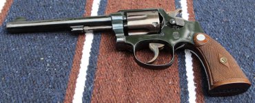

Interesting. I have one (6275nn) that I'd swear is not a reblue. No dished screw holes, all stamping sharp, case hardening on hammer and trigger show virtually no wear. It's really pristine. Yet the cylinder is plum-colored, as is the ejector rod. (And, yes, all the numbers match.)

Browning and bluing of gun parts is a controlled rust process. As others have stated, nickel does not rust so therefore high content nickel steel does not always take the bluing or controlled rusting process well. When you ad to the mix, heat treating, improper temperature, weakened bluing salt solution from over use and 100 years of age, it is not unusual to see different parts of a firearm take on different shades of blue or even plum.
There are a gazillion firearms that have taken on this color change and not all are refinished. ;)
