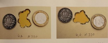

Of course, leave it to the Swiss to devise something even better!
Here's a rest for the SIG P-210.
Note it uses a sliding cradle made from a massive steel L-beam with roller bearings to take up the recoil.
And, 10 shot 25 meter groups.
