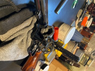

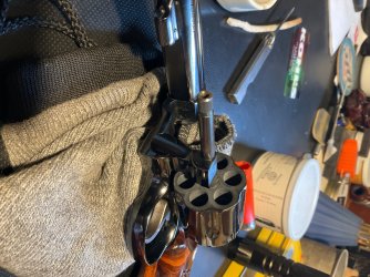

What I look for in a Smith that I suspect has had a reblue is #1 the front of the extractor Where you push to extract empties should be in the white. rebluers seldom clean the blue off of it. 2nd is the base of the pin usually covered by target or magna grips but can be seen with service grips is buffed flat during prep for a reblue.

Thanks for the input. It's in the white, untouched. I attached pix below. Thanks again.
