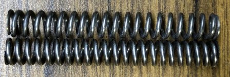

Here is a photo of the old mainspring (bottom) and new mainspring (top).
Old spring is 2" long, .27 diameter, .05" wire, and 22 coils.
New spring is 2" long, .27 diameter, .05" wire, and 18.5 coils.
Assembling with the new spring was much more difficult - I needed to do the tie-strap trick to get it started.
I don't know what other changes the new spring will make, but it will certainly apply more pressure to the firing pin.
It probably makes no difference, but the coils are wound in the opposite direction.

Don, it is a Model 41 spring. According to all the sources I checked, this is the spring that goes on a Model 52. Numrich and Brownells gave me the same information.

I don't in any way feel like a 'smith, maybe a trainee working for you, somewhat. An apprentice. I do think the new spring is going to give it about 20% more kick.
I do recall that a spring with more coils is stiffer than a spring with fewer coils. Since the gun is close to working, I think this added power will allow it to work as intended.
