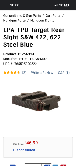

Where can I find a adjustable rear sight for the 422 or 622? Will any other S&W sight work ? thanks for the help

I have purchased these sights in the past and was very happy with them. They are probably hard to get so you might have to do some digging

Fit and function is awesome with the LPA.
those sights will not work, my 622 is not dove taled, it has the long slot like the S&W revolvers have
