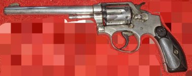

Hi Everyone! I just purchased a hand ejector in .32-20, and am not sure which model it is. (I am certain it was not the .32 cartridge I had hoped for, but that's a story for a different time.)
Here is what I see:
  • Hand Ejector
  • "32 Winchester Ctg"
  • Nickel Finish
  • Serial 55X (3 digits on the butt)
  • Fixed Sights
  • 4 screw (no screw in front of the
  • NO underlug
  • Curved butt/heel (See pictures, I am unsure what terminology is correct here)
  • Tension screw on front of grip
Thanks for looking! (Picture background blurred to reduce file size)

It is an early (wait for it) - .32/20 Hand Ejector, model of 1899, a K or medium frame. They may have also called the chambering .32 Winchester. It is the only type that did not have the forward locking point for the extractor rod.
It has a round butt grip frame, as did all of this model's production at the time. You may have been looking for an S & W in .32 Long, but at that time they were only made on the I or .32 frame. K frame .32 Longs are scarce and usually have Target sights.
And there it is, my answer! Thank you!
I suspected it would be the wrong .32 but bought it for a cheap price with vague information, so took the gamble.

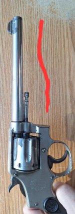

The barrel appears to cant upward slightly. When I hold the revolver frame face and ejector rod as my point of reference, they appear to be straight.
It will be looked at before firing for sure.

Here is the barrel curve/dog leg that I appear to see. The red line is a hyperbolic representation of what I see. The photos don't seem to do it justice, but it definitely looks a bit like a Garand operating rod.
It seems to cant up right, perhaps it was dropped? The smallest crescent segment of the lower left edge of the cylinder face can be seen in the locked position on every chamber.

Here is the barrel curve/dog leg that I appear to see. . . It seems to cant up right, perhaps it was dropped? . . .
You have a very big problem there, as I think the barrel is 1/4" to 1/2" high at the muzzle! The barrel/frame is indeed bent up and there is no way I would shoot the gun before addressing this problem. More likely it was used to hit something or someone. It does resemble a hammer and old-time law enforcement were not adverse to "buffalo" crooks and criminals.
You should find a gunsmith that does work on older revolvers. I would think it possible to bend the barrel/frame back into position, but one must be looking very closely for distress to the frame before firing. It would be good to take some pictures around the barrel/frame/cylinder. First, take a picture of the cylinder gap at the rear of the barrel, looking for visible space difference between the top and bottom of the barrel. Take a picture of the front of the yoke/frame to look for misalignment when the cylinder if closed. Lastly, a picture of the rear of the cylinder and the rebound plate, again looking for differences between the top and bottom of the cylinder.
Here is what a properly aligned barrel on a 32 Winchester Model 1899 should look like. Also, let me add your image and it looks like 1/4" to me.

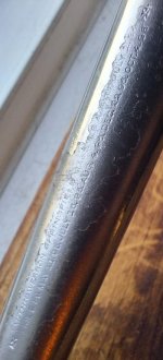

An amount of flame cutting can be seen on the bottom of the top strap. Yet the bore is quite clean. This might be the only well shot flaking revolver I've ever seen where someone cleaned it.
