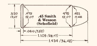

From a cartridge collector friend in Buenos Aires (Federico Graziano). This is a dimensioned drawing of an 1878 internal primed .45 S&W cartridge, taken from the Pitman Notes (Brig Gen John T. Pitman Jr. was the superintendent of the Frankford Arsenal in the late 19th Century until 1898 and made personal drawings in his notebooks of everything Frankford produced). It may help a little.
Original Drawing
DWALT,
Awesome drawing!
You can see from the information provided by member Patbar and his early cartridge including the measurements of both cartridge and existing chambers? Also the photo that I provided of the dug up round? That this is actually a drawing of the early "dual purpose" round intended to be used in both the Colt and the Schofield.
It really does also prove along with Patbar's measurements that the Schofield chamber was different from the Colts chamber even after the alteration and that the original .480 Colt diameter cartridge will not chamber in the Schofield. Even after it was altered (enlarged) to except this multi-purpose round.
The question still remains. What was the original Schofield chamber specs and what did the original round look like. It wasn't a hollow based bullet as seen in this early 1878 arsenal drawing. It might actually be earlier than that. This might be the arsenals drawing after receiving orders to manufacture the multi-purpose round in 1874/5 timeframe.
Murph

I think we have enough information though to confirm that the Schofields were actually altered upon receipt to except the "Modified Dual purpose cartridge" manufactured by the Arsenal.
Lets review:
See photo's of The Schofield 45 cartridge specs and the Colt 45 cartridge Specs. Granted these are modern drawings so I'm personally still not convinced that the early Schofield round wasn't actually a bit smaller in case dimensions.
However, we can confirm several points here.
First: The Schofield 45 and the Colt 45 "ARE NOT" compatible. NOR will the Colt round chamber in the Schofield...NOT due to length as what is commonly claimed....It's Diameter that prevents the round from going in. So this fantasy about ejection issues and case length is just that...A fantasy. "NOT APPICABLE"!
Second: When we look closely at the drawings of both cartridges we will confirm without question that both cases are straight length cases. NO TAPER, NO Bottleneck.
Third: All revolver straight cases in order to chamber require a standard clearance of 4 thousandths to chamber reliably. That is common knowledge. Example: A 38 special case is .375 and the chamber is .379...The 45 Colt is .480 and the chamber is .484. etc
Fourth: Now lets take another close look at the "Modified Dual purpose 45 Round"....Look at the excellent drawing that DWALT provided? Notice that the round is NOT a straight case round. It is a "Tapered Round" The base diameter is .478 and the mouth is .475...That is a tapered case. In order for it to chamber in the Schofield chamber? You must have no less than 4 Thousandths clearance. So, the mouth of the chamber "MUST" measure .482 and the area surrounding the mouth of the case must then measure .479.
That requires a Tapered Chamber. Which is "EXACTLY" what is stated in the letter that I provided.
Tapering the chamber to closely match the "Dual purpose cartridge".
The Colt would not require alteration since the chamber already measures .484 but again, performance in the Colt would be "marginal" at best. The modified 45 round having a .475 case mouth and the Colt having a .484 chamber? Plus the case length of the modified 45 round is significantly shorter than the original Colt 45 round so a lot of "slop" in that chamber for sure.
