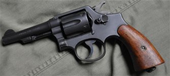

Here is my victory. .38 special I must have gotten it 30 years ago. Early 80s in one owner gunshop in N. Ca. I think I paid $75. I collected 1911s and branched out into U.S. revolvers. I believe it's dob is mid 1943. Correct me if I'm wrong and any other information would be great. I deleted the last two digits so don't think it is a 4 digit gun! THe number is # V 4922xx. No U.S. property mark. I ran into trouble trying to get the screw out of the grip to check SN. Just too tight and I am afraid of buggering the screwhead. (Update: I got the grip screw out with no damage and was happy to find the full serial number stamped on the inside right grip. Those grips were on really tight even without the screw!.) The other numbers in the usual places match. Assembly nos. on the yoke. S stamp on cyl. crane. Cylinder has serial #, P and S.
Rack number 84 stamped both stock bottoms. Flaming Bomb ordnance stamp butt next to V. P stamp upper right frame near top back edge of cylinder. V serial number and P stamp flat underside of barrel and inside extractor star. Thanks for taking a look.

78Shovel, yours is one of those made for the British, and a probable shipping date was August-September 1942. If a .38 Special cartridge will fit, the chambers have been modified by boring them deeper. At least your barrel has not been shortened, but it looks to have been refinished. It's safe to fire standard .38 Special in it but the fired cases may be bulged. You can also fire .38 S&W ammo in it. Unfortunately, the lack of the original grips, refinishing, and rechambering have a considerable negative effect on its value.
DWalt, thanks for the info. Hopefully the serial number will help with the data base. I have found a lanyard ring for it and if I run across the right grips I will bring it back as close as I can to it's original condition. I just love this thing and your info is appreciated.

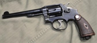

This WW2 Smith and Wesson was Canadian used. The serial number is #7372xx, with a 6" barrel. Last two serial number digits I removed from photos. This revolver came from the family of the veteran who served with the 1st Div in Africa early part of WW2. He brought back 3 handguns from the war. This one and two captured German pistols. A 1941 AC P-38 and a Nazi marked Browning 9mm. I have all three guns. THe markings on this S&W: barrel stamp 38/380 cal. British broad arrow in a C for Canadian use. Serial number matching on butt, back face of cylinder, inside extractor star and bottom barrel flat. P stamp on butt. Assembly numbers (same) on yoke surfaces. Inside right grip stamped with same serial number and same stamp used as on metal surfaces. That is all I can find save the usual top barrel address ending in 1914 date and the .38 S & W cartridge stamp with end serifs on the rt. barrel. I have had this in my collection since the early 80s, paying $150 at the time. What would be a correct holster for this pre V victory model as used by Canadian troops? Would it be a US holster (which one?) or UK model? I would like to know it's DOB-shipping date too and any other history of use. I wonder about it's current market value.

Without the V-prefix, it has a probable shipping date in April-May 1941. Obviously for British use and appears to have a 6" barrel, which is a bit unusual, as most were 5". Also, it has medallion-style checkered stocks, also a bit unusual. But at that time, very possible and very likely original and correct, especially so as the stock SN matches. The bright blued finish is also correct for this period. This is called a pre-Victory model in .38/200 (.38 S&W), aka the S&W Model of 1905, Military & Police, 4th Change, and yours is a very nice specimen of one, with a ton of character. The British official name for it was the "Pistol, Smith & Wesson, No.2" but I don't know what the Canadian nomenclature was. I know nothing about holsters that could have been used with it. I'd say it's well worth ordering a factory letter. As it appears complete, correct, and in good condition, I would say its market value would be in excess of $500, maybe closer to $700. These are not seen that often, so that's just a guess. Others may provide a better estimate. All this assumes the chambers have not been bored out to accept .38 Special cartridges. I hope not.
As is the case for most British military sidearms, and I suspect that the Canadians were no different, this revolver was issued mainly to officers, and used more as a badge of authority rather than as a primary combat weapon. Therefore, its chambering for the relatively anemic .38 S&W (.38/200) cartridge was not a great disadvantage. Of course, some went to enlisted troops who had no need (or room) to carry a rifle, such as tank crews, artillery, etc.
Thank you DWalt for this detailed information. All very good to hear. I checked and it chambers .38 S&W and not .38 special, happy to say. I will take your advice about a factory letter and report the results. One question I have for you. With this specific revolver marked for Canadian use, would the lend lease shipments in this time period have all gone to England for distribution or would this gun have been sent to Canada? Would a factory letter give that kind of information(Lend Lease) or only first shipments in the states? Thanks so much for the help.
President Roosevelt signed the Lend-Lease bill into law on March 11, 1941. It permitted him to "sell, transfer title to, exchange, lease, lend, or otherwise dispose of, to any such government [whose defense the President deems vital to the defense of the United States] any defense article." Shortly thereafter, in addition to benefiting the the British Commonwealth, Lend-Lease was extended to include China and the USSR. Lend-Lease continued throughout the rest of WWII. I do not believe there were any Lend-Lease shipments actually made to the British Commonwealth until somewhat later in 1941, as Congress had to first approve funding for the program. Prior to Lend-Lease, the British had to pay for weapons purchased from the U.S. in gold.
Your revolver was probably not part of the Lend-Lease program, as it was likely to have been manufactured and shipped before LL got underway. Also, almost all LL armament was clearly marked "U. S. Property" or something similar. Therefore, yours was probably one that was paid for in gold, and maybe one of those made for Britain in compensation for the Million dollars the British paid S&W for the abortive 1940 "Light Rifle" project. I don't think there was any reason that these pre-LL revolvers could not have been directly shipped to Canada, as Canada was part of the Commonwealth, but that's something I don't know about. The factory letter may give some details in regard to where your revolver was shipped that may or may not give a clue about direct shipment to Canada. When you get the letter, please post it here.
