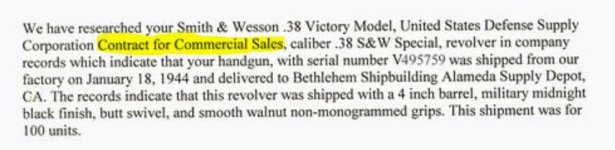

I received my S&W LOA yesterday and it answered many of my questions and created a few more. Attached is a scan of the Letter... Shipped from S&W on Jan 18, 1944 as part of a DSC contract to Bethlehem Shipbuilding Supply Depot, Alameda,CA. The specific order was for 100 revolvers. I actually had an opportunity to briefly discuss this revolver with Roy Jinks. He informed me that a 100 revolver order to a specific purchaser from a DSC contract is odd in that it was very large order, most were quantities of 5 - 15. In addition, some revolvers shipped for the US Marine Commission were direct USMC contracts delivered to their warehouses ... some via DSC contracts, shipped direct to Maritime Commission controlled entities like this one. No idea what the USMC #55 marking is... had it been placed there to track who was issued the weapon, why not just a serial number ? Maybe something as simple as a badge number, ship hull number, personal ID number for quick ID... and why such a large revolver order in 1944 by Bethlehem? Who really was the end user? We may never really know unless some Bethlehem or USMC records might shed some light on it. As Roy told me, S&W records only list the Government specifications, authorization for delivery and the initial delivery point of the weapons. Very interesting...

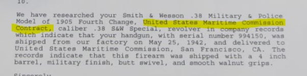

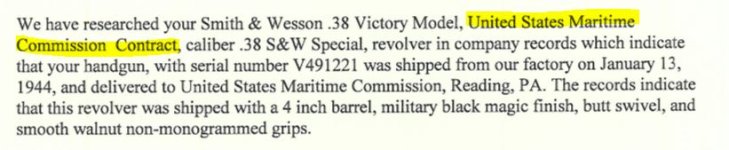

I don't have Pate's book (yet), and maybe he sheds light on this, but based on what I know so far, guns acquired under a DSC contract (like the one discussed here) were different from those acquired by the USMC. Compare the wording in Mike's letter with that for two other Victorys (apologies to the unknown donors) attached below. I think this clearly indicates these were two different types of contracts, so any categorical statement of who "owned" the guns seems problematic based on the available evidence.
