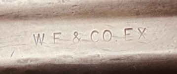

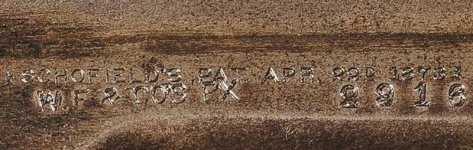

I just confirmed the origin of the "Property Stamp" on the now confirmed "Second Contract" for the Wells Fargo Schofield 45 Express gun as being from:
VOLK STAMP & STENCIL Co. 151 E. Jefferson, Detroit
We know the first contract was initiated in the year, 1881-2. Those guns in that contract have the property stamp seen in photo's 1&2. This new information also supports this stamp seen in photos 1&2 as being the first contract.
The second contract was initiated in 1891. Which is an extreme surprise to my research but is strongly supported by the 2nd introduction of US Surplus Schofields in Hartley & Grahams catalog "and" the now proven matching die stamps that came from the Volk Stamp Co that "began operations" in the year 1890. Fits like a glove.
This new information supports and extends the Schofields field service up to the turn of the century when more modern DA's and Colt SAA's were being ordered directly from the factory by Wells Fargo. The research is now very fluent and fills the gap as to why I couldn't find earlier contracts to replace the Schofields. So the service time is now 1881-2 to 1899. Almost 20 years!
The second contract stamp is seen in photo 3. The proximity to Chicago is seen in photo 4. So this contract was likely marked and distributed from the Chicago Express office which also fits my research. A pretty huge breakthrough.
These are the only two confirmed contracts. There may have been smaller contracts but proving them as legit is very difficult.
Murph

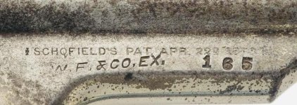

Here are some examples of legit 2nd contract Wells Fargo Property Stamps and unproven markings;
Photos 1&2 exhibit correct and proven Wells Fargo 2nd contract stamps from 1891 time frame.
Photos 3,4&5 exhibit unsupported examples that follow no pattern in my research and are unproven markings. I have several others in my research documents. Single unique examples like these are literally impossible to prove legitimate unless several more show up with identical markings that prove a pattern to support a smaller contract purchase by Wells Fargo.
Before the collector rules out a potential purchase, keep in mind that a large number of the Schofields were also purchased at the same time by AMERICAN EXPRESS those examples are marked totally different but exhibit the exact same contract features and barrel cuts as the WELLS FARGO examples.
Murph

Conflicting Information
Murph, following is quoted from the SCS&W 4th Edition, page 113:
""The marking reads "W.F. & COS EX" along with a re-stamping of the guns serial number. The S was dropped from the company name in 1898, and guns are found marked both ways, suggesting the period of use.""
Further down on the same page the marking on Wells Fargo serial# 1 is pictured and described as ""Late italic, singular "CO." company marking, with small type numerals.""
This seems to indicate that those correctly marked with the singular "CO.", such as those pictured in your photos 1 and 2 in post #1 above, were stamped in or after 1898. However, you describe these as examples of the first contract initiated in the years 1881-2.
I see a disconnect between your information and the SCS&W regarding those stamped with the italic singular "CO." company marking with small type numerals, and I'm wondering which is correct. I'm hoping your information is correct, but at this point I'm confused.
