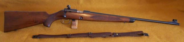

Winchester Model 52 Sporters all had inletted swivels (Super Grade). A number of 52 Target models were modified because of the price difference. Proceed with caution!
Here's a legit B Model...
