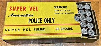

Not FBI loads, but probably pretty stout........
While not the FBI loads from Buffalo Bore, I have a feeling these are probably right stout! I have some 158 grain ammo from the same manufacturer, but it is .357 Magnum.

Hotter than FBI load?
I am wondering if this is hotter than the FBI load? Knowing the rep of Jurras and the old Super Vel company, I have a feeling it is......

I'd have to look up the data to be sure, but I think CUP pressure on this loads was around 22,000 - 24,000, fifty years ago, according to testing done in the Super Vel lab. They also tested the Norma 110 grain - the hottest .38 Special factory load ever as far as I am aware. It had a pressure of around 27,000. It's important to remember that this was before the +P designation.
At the time, if it said .38 Special on the box, many fired hot factory ammo in any .38 Special revolver. Never heard of one being destroyed, but I'll bet there are a few loose .38 revolvers out there. Refreshingly, it was impossible to ask "Can I fire +P in my gun?" and there were no arguments about doing so either.
That is some really hot stuff, probably nastier than BB. They used 9 mm (.355") bullets in their 357 Magnum and 39 Special ammo in an attempt to keep pressure down and velocity up.
