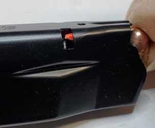

I understand that the dimensions of the follower includes a "no-bind" design.
Cutting off the "fangs" may compromise the anti-bind effect?
Can you please post a photo of a fangless follower? :D
Is this pic before "fang" removal? What are the fangs?
File an angle on the fangs like s&w did on the later mags. They won't catch on the mag catch slot.
I picked up a 12 round mag today. Tried to load more than 10 it would not take 11. Took it apart and looking at the spring and how the coils are supposed to nest inside each other. A few measurements I found the small coils a bit to big and wouldn't nest inside the large coils. A slight squeeze with pliers on 2 coils fixed the problem. Now they take 12 rounds.
I took my 12-round mag apart. I believe I see what you described and the "nesting coils". I tried 3 times after giving some squeezes to the coils that appeared to be anti-nesters. I gave up. I'll just carry 1 round short of a full mag. :)
Or, just push a finger into that hole when loading the third round until "you" have time to file it. It's not too big of a deal once you know what's going on.
