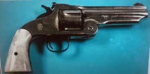

Interesting
I had a few mins between projects and did some researching.
Here is a very interesting short barrel 2nd issue American.
Notice it has a S&W logo on the right side frame?
That stamp didn't happen until 1896ish.
I wonder if the OP's short barrel has the logo stamp?
That stamp has no business being on that American frame!
Unless? It left the factory that way.
Murph
Notice it has a S&W logo on the left side frame?
Murph
Very interesting. The one in your photos has an even shorter barrel it looks like.
That stamp is not on this one - there's definitely no marks on the exposed part of the frame other than the serial. The guy whose possession its in says no marks on the metal under the grips either - but I haven't seen under them myself to verify.
