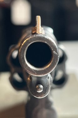

After the excitement was over, I stepped back to the 5 yard line and gave Leroy a try just to see if I really needed that front sight. Yes...I do. :rolleyes: Trying to align things using just the groove in the top strap didn't work well at all.

Leroy's most obvious issue is that he's missing his front sight blade due to a barrel amputation.
I kinda like how it looks without the front sight. Makes it look like one of those old-time prize fighters with the busted-up, flattened nose.
Makes it look mean and business like.
But yea. If it was mine I'd put a front sight on it.

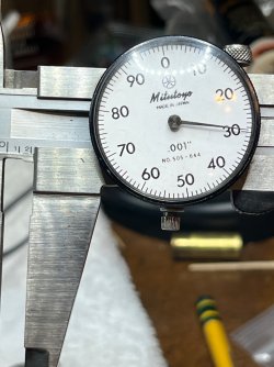

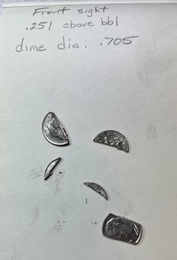

Step one was to measure the front sight on Larry Brown, Leroy's inbred cousin from back in the hills. (Larry will get his own write up someday...). Larry's front sight measured .251" tall, but Larry has a 3 1/4" barrel while Leroy's barrel is only 2 1/2-ish. A .250" sight will probably be a smidge too tall but it's a good starting point.

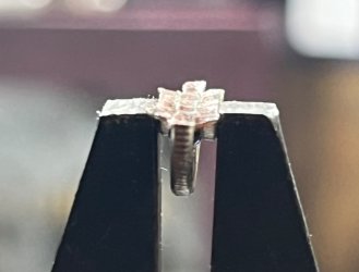

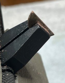

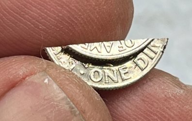

Step two was to mangle a couple of dimes into some rough pieces that would eventually form our proof of concept front sight.
The main piece that would form the "blade" was clamped into a parallel clamp, which was then mounted in the bench vise and the bottom of the cut was trued up with a file.
After a few minutes with the file and several measurements (you don't really want pictures of every measurement, do you?) we ended up with our .250-ish front sight blade. Yes, I went just a bit too far. Trust me - it gets much worse.
The two smaller pieces that would make up the "base" of the front sight were vastly different sizes due to the fast-n-sloppy way I cut them with a pair of tin snips. One was .107" tall, the other was .124" tall. In order to make them match, I decided to file them both to .100". In retrospect, this was way too small. The next iteration needs to have these pieces be more in the .140" to .150" range.

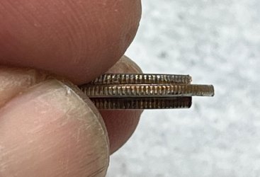

Here are our 3 pieces after sizing....
The 3 pieces were expoxied together to form a sandwich with the tall piece in the middle.
This worked, but the next time I do this I won't be so cheap and I'll spend 30 cents and use 3 full size dimes. They'll be attached to each other with solder and then I'll shape the unit instead of the individual pieces.

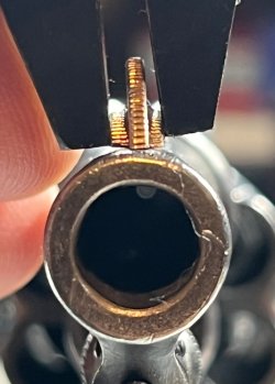

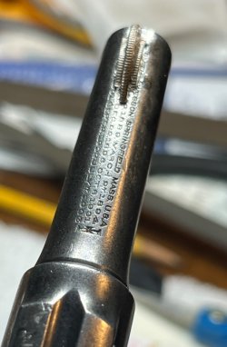

My dime sandwich front sight had a mostly flat bottom and Leroy has a round barrel (shocking, I know).
I needed to cut a round channel into the bottom of the sandwich to shape it to the barrel. Instead of spending the time with a round file, or setting up the drill press with a sanding drum the same diameter as the barrel and feeding the sight into the sanding drum a little at a time with the drill press vise, I did the intelligent thing and grabbed the rotary tool of destruction.....and proceeded to completely mung up the bottom of my dime sandwich.
It started out mostly ok and looked like this after the first pass:
But it needed just a bit more to match the barrel profile, so out came El Destructo again and I leaned in a bit too hard......
Five seconds with the Dremel destroyed an hour of filing and measuring. I deserve that for even thinking about using that cursed thing. I almost started over at that point, but I reminded myself that it didn't have to look pretty - it just had to work for a shot or two. So let's see what we can salvage....
The "sight" did fit onto the barrel even though it looked like hammered dog poop.
To find the centerline of the barrel, I used the extremely scientific method of laying a straightedge between the dingbats at each end of the top barrel stampings and drawing a line with a sharpie. The dime sandwich was then epoxied to the barrel. Removal is going to be with a big hammer when it's time to make the real front sight.

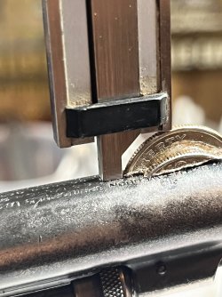

Ok…I find this amusing. D Brown is an educated man who did a bunch of mathing and came up with .2295" as a proposed starting height for the new front sight.
The pictures above show how badly I butchered the "sight" by trying to freehand it…..and here's the measurement of the installed piece:
