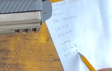

I've been thinking about the video with the guy with the wood screw who points out the play/slop between slide and frame, and shows how the P320 can discharge when the slide is manipulated while the trigger is held motionless by the wood screw just beyond the wall.

I watched someone take a P320 apart and work the safety lever on the striker. The safety lever moved out of the way of the striker almost immediately upon trigger movement. This is important because the striker is free to move forward with almost no movement, or very little movement, of the safety lever. Why wouldn't you design this striker block to come away from the striker at the very end of trigger movement instead of at the very start of trigger movement. This makes no sense to me at all!!! This is one of the most unusual designs I have ever seen and I have seen a lot of designs at my age.

Unless I'm misunderstanding which side of the wall you mean by "just beyond the wall," the screw didn't hold the trigger just beyond but instead just BEFORE the wall. The screw only removed the take up slack so the trigger was starting from the same condition every time and producing the same repeatable results. The screw barely moved the trigger from its rest position. The reason he did this was to illustrate how the possibility of slightly out of spec parts or part mounting true positions could render the gun in a dangerous condition. Also, if a LEO were to draw the pistol to aim it at a threat, place his finger on the trigger slightly, would it then fire uncommanded by the slightest jolt without pulling the trigger past the wall? Would it setup a dangerous condition where it might then fire upon reholsering, etc? The bottom line is a properly designed pistol to accepted industry standards should not be that sensitive and should never be accepted in the marketplace, and a responsible, moral company should take the lead in removing such a flawed design from the marketplace.

Unless I'm misunderstanding which side of the wall you mean by "just beyond the wall," the screw didn't hold the trigger just beyond but instead just BEFORE the wall. The screw only removed the take up slack so the trigger was starting from the same condition every time and producing the same repeatable results. The screw barely moved the trigger from its rest position...
Start watching the video again at about 9:00 minutes in.
"...66.62 is the wall... the beginning of the actual trigger pull where we are moving parts.... 65.69, less than one mm..." and the gun fires
Take a look again from about 9:00 minutes into the video,
"66.62 is the wall, the start, the end of the pre-travel, the start of the actual trigger pull..."
He then puts the screw in, moving the trigger to 65.69.
"Let's see if we can get it off by just touching the slide..."
The striker actuates.
"How about that?! That measurement right there. I am not a math wizard but that is less than one millimeter... into the firing sequence and it just dropped the striker."
Maybe the difference between your statement and his is how one defines the wall, but that is how he defines it,
I would argue that the trigger pull begins with taking up the slack, or pre-travel.

My problem with the video and the screw is that he continues to say that he was not touching the trigger, but the screw simulated him putting pressure on the trigger. ANd to top it off he began to place the pistol in a holster when it "went off" with the screw in place. Not a Sig fan and I have no idea how the Airman's pistol went off when holstered in a Safariland holster with a QLS.
tjg63: If you read through this thread you will see that most, if not all, of your questions and concerns are addressed herein.
Roger that. I mistakenly thought that the screw was just removing the pretravel to the wall. Still, if the trigger hasn't been pulled to the sear break, a mechanically sound, well-designed handgun should never fire by jiggling the slide or creating vibration on the gun.
