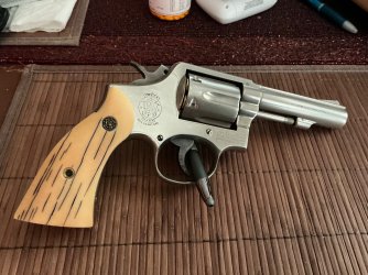

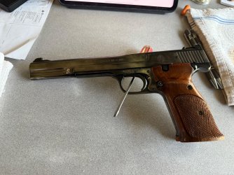

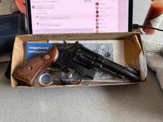

I sold my 320 before the auto discharge issues came up. Dry firing felt like a toy gun. I simply didn't like the gun. Got my $ back, because it's a plastic fantastic gun. Just getting to like steel and wood more and more.
