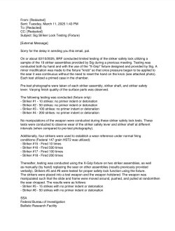

Here is a 7/24/25 Sig release which includes an FBI email* to Sig discussing the subsequent FBI testing which was unable to repeat the failures.

* The FBI email linked in the article is hard to read. Here is a clean text version as reproduced by ChatGPT:
