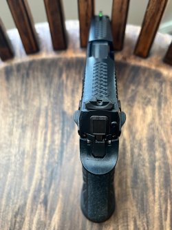

Mentioned earlier in either this thread or the other on the topic, I bought a P320 about a year ago before I was aware of the issue.
Actually, being me, I bought a Wilson Combat modified P320. (Then further sent it to Sig to add a thumb safety as Wilson Combat, for whatever reason, no longer offered them with a thumb safety.)
I think I paid about $1400, before paying Sig ~$200 to add the safety.
By what I am sure is sheer coincidence and absolutely nothing to do with the topic of this thread, I was on Wilson Combat's site yesterday and their WCP320s are marked down several hundred dollars.
