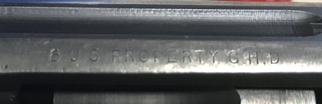

Can someone help me with the markings on this Victory?
It has "C.H.D" after U.S. Property on the top strap and "WB-S-MAN" on the back strap
It’s G.H.D. and those are the initials of Guy H. Drewry, officer in charge at the ordnance district whose contractors performed the inspections at the factory.
Your gun was issued to police in US-occupied Germany in 1946.
WB = Württemberg-Baden, the state
S = Schutzpolizei or Stadtpolizei (municipal police)
MAN = Mannheim, name of the town
