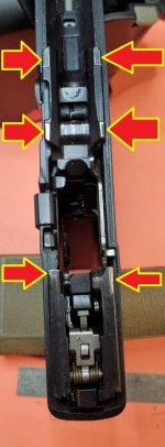

BG2.0 Misaligned Slide Rails
Type a note describing the issues you have and include pictures. Pictures of targets noting the distance and brand used. Include a copy of the note you received from S&W. You could highlight what the tech said if you choose. If you call CS before sending it back, take notes of what they say and who said it recording date/time. That sounds over the top, but apparently someone shouldn't have a job in the service department. I would think S&W would want to know about manufacturing defects, but I could be wrong.
Tried your suggestions, seemed to work. Got another RMA number. The guy issuing the RMA said it is flagged to go directly to a supervisor.
First time it went to Springfield MA, this time it's going to Maryville TN. Hopefully they can get this sorted out.
To others who say it could be the shooter and not the gun… I have no doubt the shooting inaccuracies could be operator induced. Just because I have thousands of rounds through my LCP does not mean I can shoot a BG2.0 effectively. For example, I can shoot my p80 G17 clone perfectly fine but hand me a real G17 and I'll shoot left of center all day long with it.
But I feel like the problems of my BG2.0, being difficult to rack without a barrel and recoil spring installed and the front of the slide dragging on the right side of the frame, need to be addressed. Once those issues are fixed if I'm still struggling to get lead on paper I sure don't mind seeking out professional instruction/assistance. There is an excellent indoor training facility less than an hour away from my home.

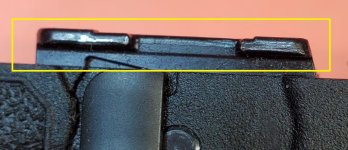

The vertical difference in the fore and aft rails I have seen on other pistols. The apparent twist of the front rails compared to the rear one looks distinctly odd. I could be misreading the perspective, but it looks like the left rail is pinched inwards. Perhaps a picture looking straight down on the action would confirm my observation.
Your observation of "it looks like the left rail is pinched inwards" is correct and one of the first things that caught my eye when I initially removed the slide. Glad that came through in the pics. Hopefully the repair tech will see that too.

You show in your pictures a step in the rails of the frame. Now tell me if there is a step in the rails of the slide? Once installed on the frame (spring(s) and guide installed) is the slide loose? The pistol is not designed to function without these parts installed. Does it wiggle and wobble excessively? A little rattle is not indicative of a bad fit. How is the barrel to slide fit? These are all questions I would be asking myself (and getting answers for) before I ever sent it back to the mothership.

Update on rail alignment:
I'm about 100 rounds through my BG2.
I just measured with a straight edge the angle and parallel of the 4 front rail contacts and the two rear rail contacts. They are now nearly parallel.
The two rear rails are still about 0.015" higher than the 4 front contacts. There is visible shiny wear nearly equal on the 4 front contacts.
The shiny wear area on the two rear contacts indicates the back of the slide is hitting at the front of rails. I can also see wear areas on the sides of rails.
The shiny wear areas are increasing so it appears there is some "breaking in" going on.
The photo doesn't quite show the shiny surfaces of the contacts surfaces.
