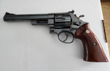

My one and only rescue is a 1978 vintage Model 28. I bought it with some rust and some pitting knowing that it would be a refinish project revolver.
The refinish job was $185. The bluing came out quite dark and "royal" looking so I got the white grips for contrast.

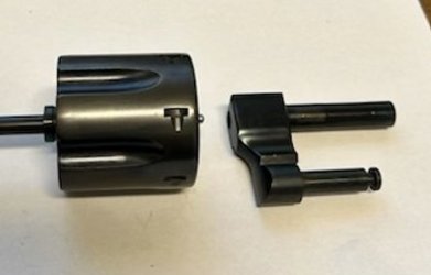

Looking at the pictures, in my opinion that cylinder can be restored and appropriate to the gun. It will need to be stripped, polished and blued. Here's one I did about a year ago. It was worse than yours with rust pits, scratches and gouges from being dropped or something. I pulled the cylinder and inserted the ejector rod in a drill, used 220 grit wet to start off with at a low rpm and kept the paper flat (so the flutes wouldn't get rounded), until the surfaces were smooth, followed by 400, 600 and 800 wet. I hand polished the flutes with 400 staying away from the edges, then cold blued it with Super Blue. I have also used rust blue in the past but it leaves more of a matte finish and it's a lot more work.
