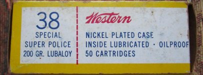

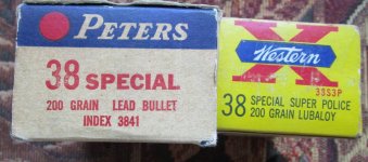

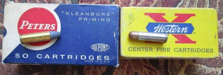

Off the shelf? Well maybe many years ago, I've not shot any through my 38/49/649. Maybe some of our elder LEO's have experience with this stuff. Two totally different 200 grain bullets and Western called theirs the Super Police. I suppose I should run some through my old Bodyguards.
